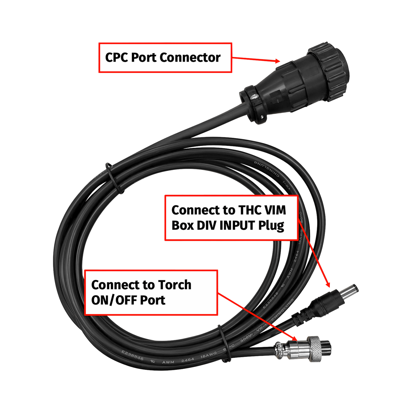

Use this 6ft plug-and-play Hypertherm CPC cable to connect your Hypertherm Plasma Cutter to our CrossFire CNC Machines. No splicing into trigger wires or raw voltage is needed to fire your torch or use Langmuir Systems Torch Height Control. NOTE: Be sure to choose the correct version based on your CNC Machine.
Works with:
- Hypertherm PowerMAX 45/65/85
- Hypertherm PowerMAX 45XP/65XP/85XP
- Hypertherm PowerMAX 65SYNC/85SYNC
To use:

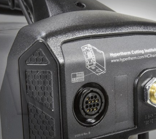

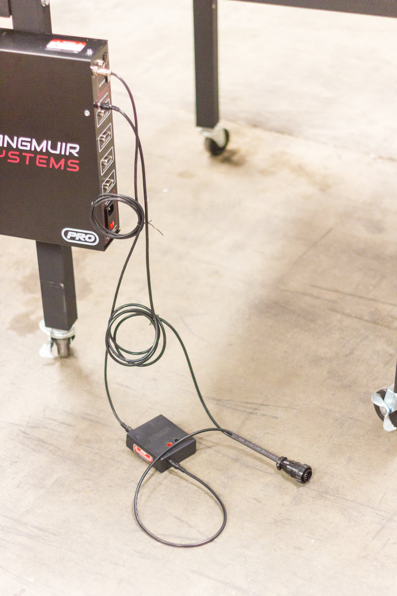

- Insert the Hypertherm CPC plug into your Hypertherm Plasma Power Supply.

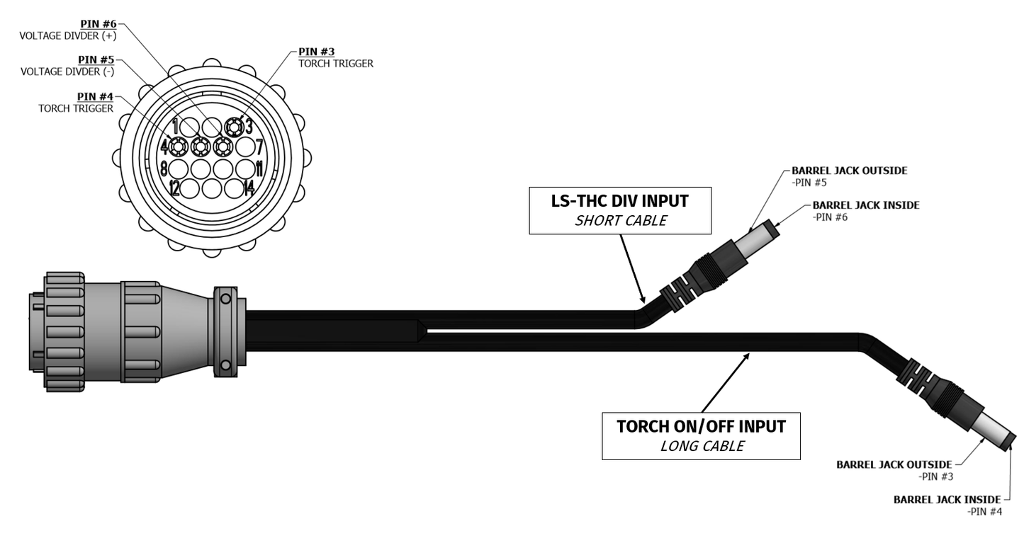

- Plug the longer cable barrel connector into the CrossFire Electronics Torch On/Off port.
- If you have an LS-THC unit for your Machine, plug the shorter cable barrel connector into the DIV INPUT on your VIM Module.
Note: Use of this cable requires a CPC port and Hypertherm Machine Torch.
Note: If using a Hypertherm PowerMAX 65 or 85, be sure that your voltage divider is set to 50:1 before plugging into the LS-THC VIM module (50:1 is the default setting).
Wiring Schematic
