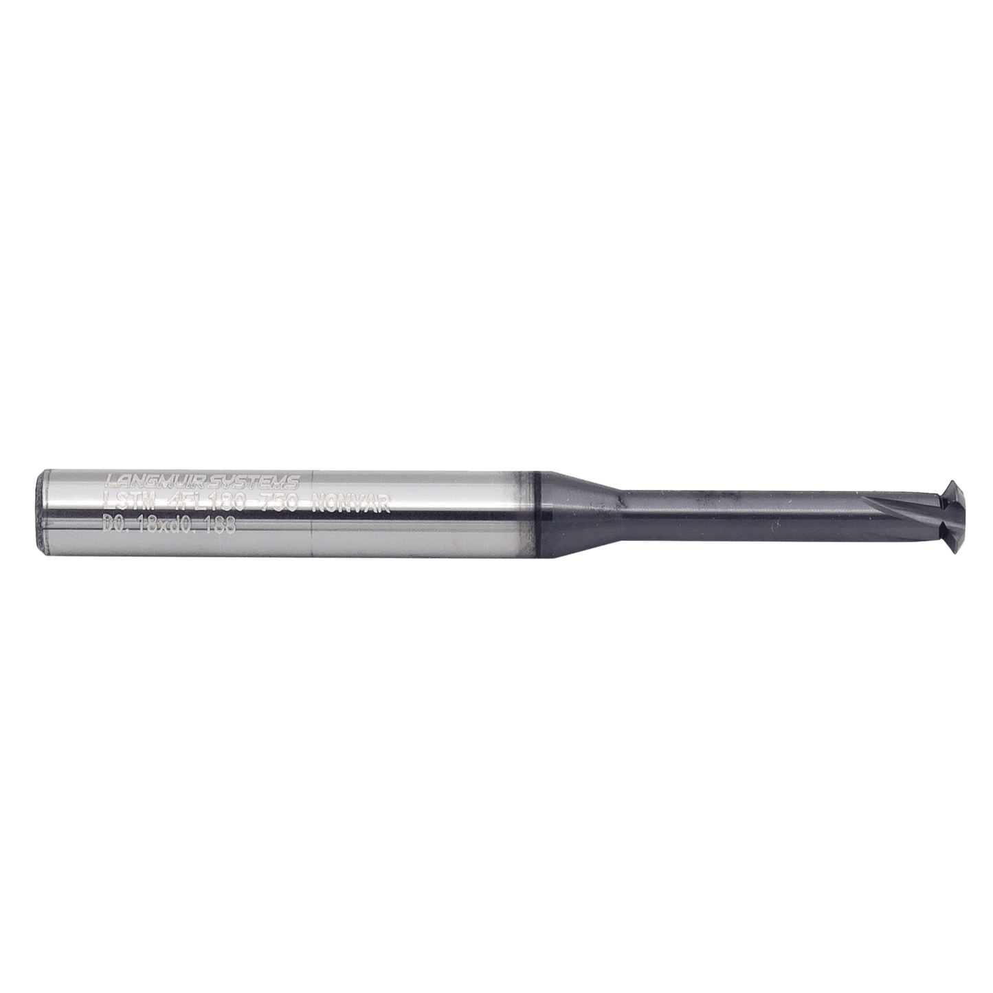

AlTiN Coated MR-1 1/4" Thread Mill for the MR-1 CNC Gantry Mill.
Elevate your threading capabilities with the AlTiN Coated MR-1 1/4" Thread Mill. This tool is specifically designed to tackle a variety of threading tasks with precision and ease.
Key Features of the MR-1 1/4" Thread Mill:
- Specialized Threading Tool: Specially designed to produce 1/4” threads, offering a thread range of 18-56 threads per inch. Therefore, making it highly versatile for different threading needs.
- Wide Application Range: Capable of producing not only standard metric threads but also custom thread profiles. As a result, accommodating diverse project requirements.
- Effective on Various Applications: Performs excellently in both internal diameter (ID) and outer diameter (OD) threading tasks. Thus, enhancing its utility in your milling operations.
- Precise Cutting Dimensions: Features a cutter diameter of .180 inches and a neck diameter of .115 inches for precise and controlled cuts.
- Depth and Length Specifications: Allows for a maximum thread depth of .033 inches and a length of cut of .750 inches. As a result, ensuring deep and extended cutting performance.
- Durable Build and Coating: Enhanced with an AlTiN coating for increased durability and performance. Indeed, extending the lifespan of the tool under rigorous use.
Perfect for professionals and enthusiasts alike, the MR-1 1/4" Thread Mill is a reliable choice for achieving detailed and accurate threading on your MR-1 CNC Gantry Mill. Whether you're working on small-scale precise projects or handling custom fabrications, this thread mill ensures top-notch results and a smooth machining process.
