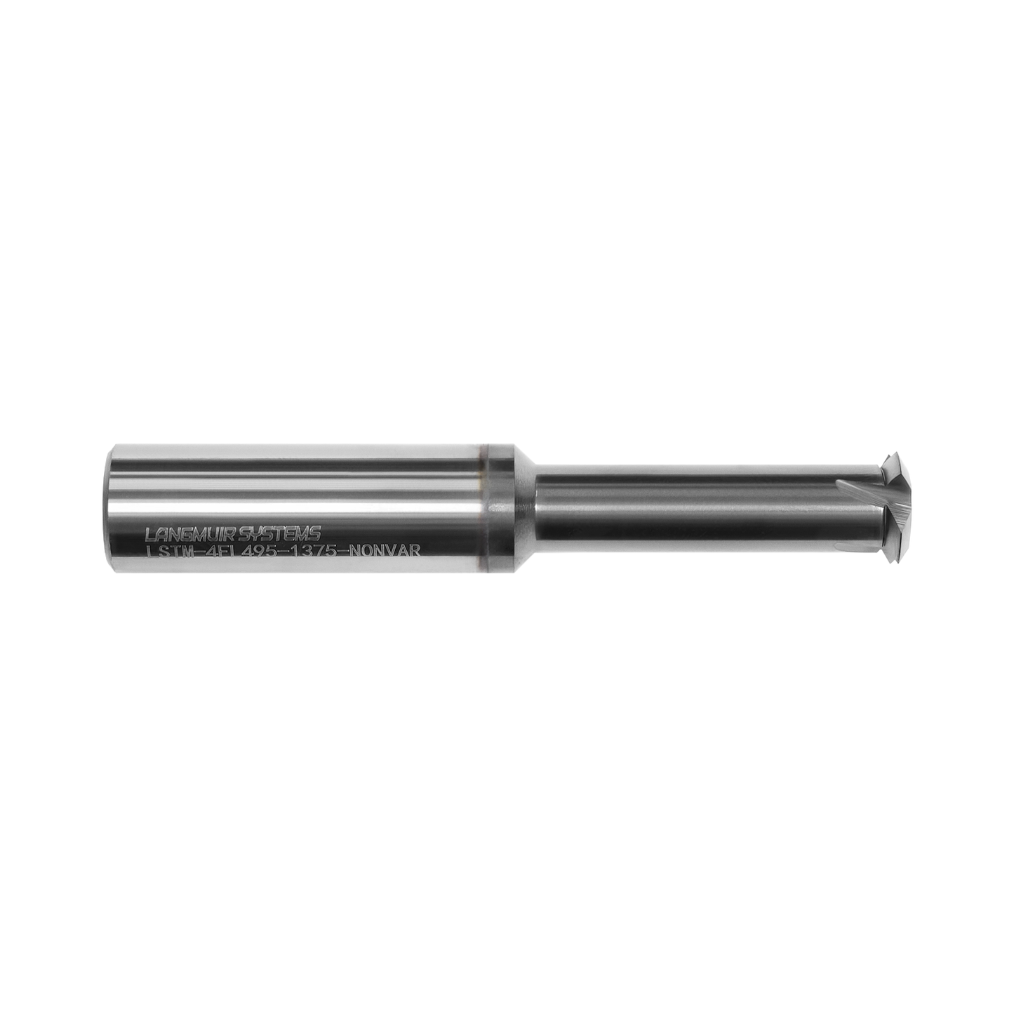

AlTiN Coated MR-1 3/4" Thread Mill for the MR-1 CNC Gantry Mill.
Upgrade your threading capabilities with the Langmuir Systems MR-1 3/4" Thread Mill, meticulously designed for both industrial and custom threading applications. This tool excels in creating precise 3/4” threads, with the flexibility to manage a wide variety of threading tasks.
Features Include:
- Versatile Threading: Primarily designed to produce 3/4” threads at 10-32 threads per inch, offering unparalleled precision and reliability.
- Wide Application Range: Not limited to standard sizes, this thread mill adeptly handles metric and custom threads, enhancing its utility in diverse machining setups.
- Dual Functionality: Performs with excellence in both internal diameter (ID) and external diameter (OD) threading applications, ensuring comprehensive threading solutions.
Robust Design Specifications:
- Cutter Diameter: Measures .495 inches for effective cutting.
- Neck Diameter: Stands at .340 inches, providing stability during cutting.
- Maximum Thread Depth: Reaches up to .078 inches, allowing for deep thread cuts.
- Shank Diameter: Sized at .500 inches to fit standard tool holders.
- Length of Cut: Extends to 1.375 inches for deeper and more effective cuts.
- Overall Length: Total length of 3.000 inches ensures compatibility with various milling setups.
- Coating: Features an AlTiN (Aluminum Titanium Nitride) coating, enhancing the tool's durability and wear resistance under tough conditions.
Expand Your Toolkit: Equipping your MR-1 CNC Gantry Mill with this thread mill not only broadens the scope of your projects but also injects efficiency and precision into your workflow.
