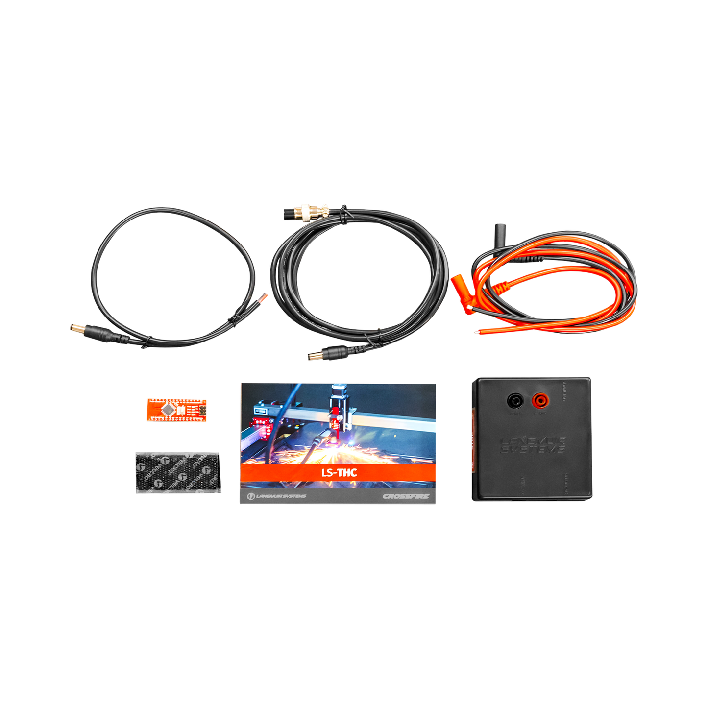

- Voltage Input Module: Each THC kit includes a separate Voltage Input Module (VIM) for hooking up to either a plasma cutter CNC port or directly to raw plasma terminals for maximum compatibility.
- Upgradable: The THC unit is designed so that your Gen2 CrossFire or CrossFire PRO machine can be upgraded to run with the THC system at any time by purchasing the THC module and plugging it into the Motion Control Board inside the electronics enclosure.
